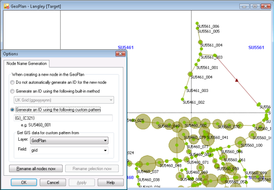

GIS data from a nominated layer in the GeoPlan will be appended to the node name. When using the {G} variable, the Get GIS data for custom pattern from section will become available. This section contains dropdown lists of Layers displayed in the GeoPlan and the Fields of the selected Layer. This is of particular use when using a coordinate grid layer. Example
Nodes Renamed using GIS Grid Layer To adjust which characters of the GIS Layer Field appear in the node ID, add the digits corresponding to the location of characters in the field, to the variable. The characters are numbered from left to right. e.g. from Layer field containing grid coordinates in the form SU5163 {G3456} = 5163 |

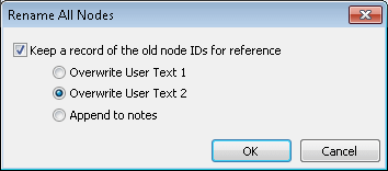

Clicking on the rename buttons displays a Renaming dialog.
Existing Node IDs will be overwritten by the renaming process. To keep a record of existing Node IDs, check the Keep a record of the old node IDs for reference box. Choose to store old node IDs in User Text 1 or User Text 2 fields (this will overwrite any existing data in these fields), or to append the node ID information to the Notes field.
