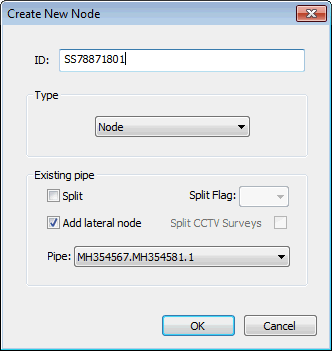

New Node Dialog
Displayed when digitising a new node on the GeoPlan or Long Section Window to create a new node.
Enter a unique identifier for the node (the node ID will be automatically populated if Automatic Node Name Generation is switched on).
Select node Type from the dropdown list.
Nodes may be inserted into an existing pipe by checking the Split box. Select the pipe to be split from the Pipe: dropdown list and set a flag for calculated pipe lengths and invert levels if required. When working with Collection Networks, the option to automatically split CCTV Surveys associated with the link to be split is also available.
Nodes may be added as lateral nodes to a pipe by checking the Add lateral node box. Select the pipe to which the node is to be added from the Pipe: dropdown list.
When working with Distribution Networks, the option to specify a Pump Station ID is made available when creating a pump object.

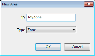

New Zone / Area Dialog
Displayed when digitising a new zone / area on the GeoPlan to create a new zone /area.
Enter a unique identifier for the zone /area (the ID will be automatically populated if Automatic Node Name Generation is switched on).
Choose the type of zone /area from the Type dropdown list.

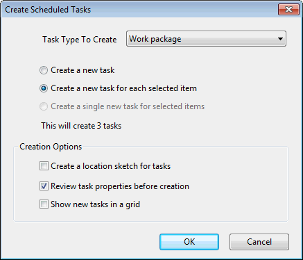

New Scheduled Tasks Dialog
Displayed when digitising a new survey or repair task, or a work package on the GeoPlan to create a new scheduled task.
Choose the task type from the Task Type to Create dropdown list.
Please refer to the Create Scheduled Tasks Dialog topic for more information on the other options available on the dialog.

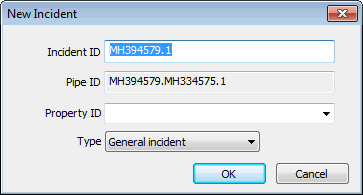

New Incident Dialog
Displayed when digitising a new incident on the GeoPlan Window.
A default Incident ID based on the associated node or pipe ID is displayed in the dialog.
If the incident is associated with a node the default Incident ID takes the format of x.n where x is the ID of the associated node and n is an index used to make the incident ID unique.
If the incident is associated with a pipe the default Incident ID takes the format of x.n where x is the US Node ID of the associated pipe and n is an index used to make the incident ID unique.
If the incident is associated with a connection pipe the default Incident ID takes the format of x.n where x is the ID of the associated connection pipe and n is an index used to make the incident ID unique.
If the incident is not associated with an asset:
- the Incident ID is generated by Automatic Node Name Generation, if automatic node naming is switched on
- the Incident ID is generated as .n if automatic node naming is switched off, where n is an integer used to make the Incident ID unique.
If the incident is created in the location of one or more Property objects, an associated property can be selected from the Property ID dropdown list (this does not apply to asset networks).

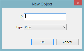

New Object Dialog
Displayed when the New object context menu option is selected for a relationship group on the Object Browser Window.
Enter a unique identifier for the object and select a Type from the dropdown list (depending on the type of the object in the relationship group selected, there may be one or several available object types).
See Using the Object Browser Window for more information.
