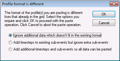

The Different Profile Format Dialog may be displayed when pasting complete profiles from the clipboard into an event. in the Event Editor.
The dialog is displayed if the profile format varies from that in the existing data. There may be:
  • different number of sub-events
  • different number of timesteps in one or more of the sub-events
You may not be copying the data you expected. If this is the correct data then the options on the dialog are fairly self-explanatory.
