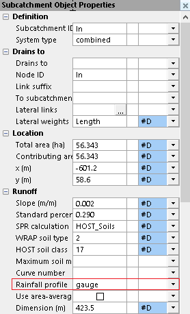

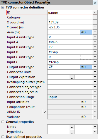

TVD Connector (1) Properties: Subcatchment Properties:
References to the Scalar TSD are made via the Input A units type, Input B units type and Input C units type fields in the TVD connector's property sheet. The Connection usage must be set to Input.
See TVD Connector Data Fields for further information about these fields.
TVD connector (1) can be linked to the subcatchment by specifying its ID in the Rainfall profile field in the subcatchment's property sheet.
See Subcatchment Data Fields for further information about these fields.

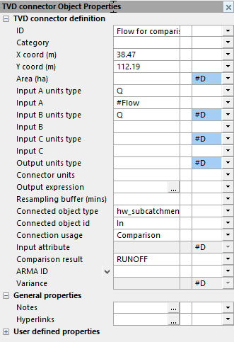

- TVD connector (2) which may be used for comparison purposes should contain a reference to the flow input from a Scalar TSD. TVD connector (2) must also reference the subcatchment with which it is associated.
Example
TVD Connector (2) Properties:
The following properties must be set as follows:
Input A units type is set to Flow. This references the flow from the scalar TSD object to the TVD connector.
Connection usage is set to Comparison.
Connection object type is set to hw_subcatchment and the Connected object id is set to the id of the applicable subcatchment.

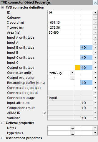

- TVD connector (3), required if, for example, potential evaporation is to be generated as a profile. This TVD connector requires an output expression to generate the profile.
TVD connector (3) must also be referenced by TVD connector (1), i.e. the one referenced by the subcatchment, to ensure that the output expression, set in TVD connector (3), is used as input to the calibration process.
Example
TVD Connector (3) Properties: Time-series expression (example for a yearly sine curve) TVD Connector (1) Properties:
A time series expression can be specified via the Output expression field.

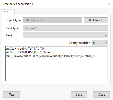

An expression for a yearly sine curve is specified in the Time-series SQL Expression Dialog (displayed when the
button is selected in the TVD connector (3)'s Property sheet):
The average value over the year should be specified in the "User number 1" field of the TVD connector. This generates a sine curve with minimum zero on 1st January.

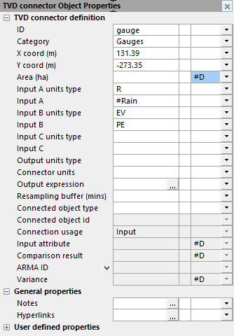

TVD connector (1) [the one referenced by the subcatchment] should then use TVD connector (3) as an input:
In order to reference TVD connector (3), TVD connector (1) must have an input units field that is set to 'evaporation', in this case, Input B units type is set to EV and Input B is set to the ID of TVD connector (3), ie PE. The Connection usage must be set to Input.
