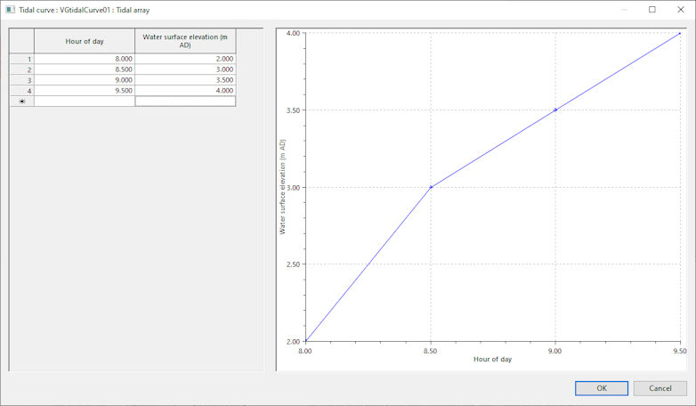

The Curve Editor is displayed when the
button is selected in an 'Array' field in a Control, Pump, Rating, Tidal, Weir or Underdrain
curve, and is used to specify the values for the curves. The specified values are automatically plotted on a graph.
The items which comprise this editor are described in the following table:
| Item | Description |
| Grid / Graph |
The values entered in the first column of the grid will appear in the X axis on the graph, while the values entered in the second column will appear in the Y axis. Descriptions of the values to be specified in the grid are contained in the following topics:
Note that the X values are to be specified in increasing order. |
