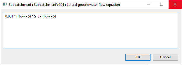

An example of a lateral groundwater flow equation specified in the editor is shown below.
In this example, a step function is specified to ensure that flow only occurs when the groundwater level is above a threshold of 5.
