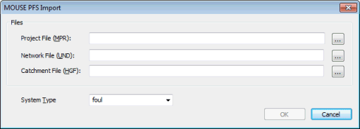

The MOUSE PFS Import Dialog is used when Importing MOUSE Network Data from pfs format.
The dialog is displayed when Import
Model
from MOUSE PFS file is selected from the Network menu.
- Enter the path to the text files to be imported, or use the browse button to select a file from a Windows File Open dialog. If a Project File (MPR) is selected, the Network File (UND) and Catchment File (HGF) will automatically be selected, if found.
- Set the network system type to an appropriate value using the System Type combo box.
- Click OK to carry out the import.
An import log will be displayed with any conversion errors or warnings.
For details of conversions made by the importer, see the MOUSE PFS File Conversion Notes section.
