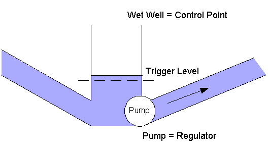

The following example shows the RTC for starting a pump when the level in a chamber exceeds a defined depth.
Under this example, the pump will be switched on when the level at node D equals or exceeds 20 mAD. When the level at D falls below 20 mAD the pump will be switched off by default.

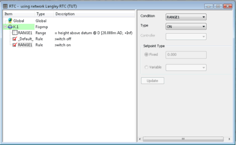

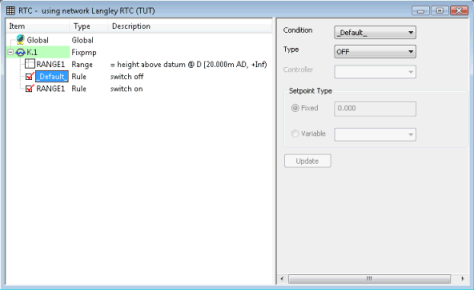

The scenario is defined by adding components to a fixed pump regulator in the RTC Window Editor.

RULE 1 |
Condition: _default_ Rule type: OFF |
Default status of pump is OFF |
RULE 2 |
Condition: RANGE 1Rule type: ON |
Switch pump ON if RANGE 1 is TRUE |

- Rule 1: Unless subsequent rules are TRUE, the pump will be set to the default status of OFF
- Rule 2: Switches the pump ON if the level at node D is at or above 20 m
