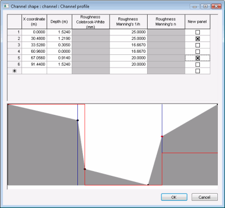

Data Group C2, C3, C4 - Irregular Channel Data
The importer creates channel shapes for conduits of type NKLASS=8 (irregular) channels. The data required to create the channel cross-section are in Data Groups C2 - C4.

Data Group C2 - Channel Roughness
SWMM4 |
Description |
InfoWorks ICM Data Field |
XNL |
Manning's n for left overbank |
Rough. (up to left panel marker) |
XNR |
Manning's n for right overbank |
Rough. (from right panel marker) |
XNCH |
Manning's n for channel |
Rough. (between left and right panel markers) |
