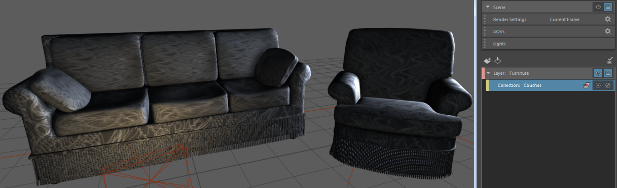

In this example, the couches are assigned to a lambert, which is mapped to a greyish texture. To assign the couches to a plaid texture instead, you can do as follows:
- With the Furniture layer set to visible, select the Couches collection, then select the grey texture file node.
- In the file node
Attribute Editor, right-click the file path area of the
Image Name attribute and select
Create Absolute Override for Visible Layer.
A file node subcollection is created, as well as a corresponding file texture name override.
- Select the override. In the
Property Editor, click the folder icon to connect to a new texture.
Enable or disable the file node override to switch between the two textures.
