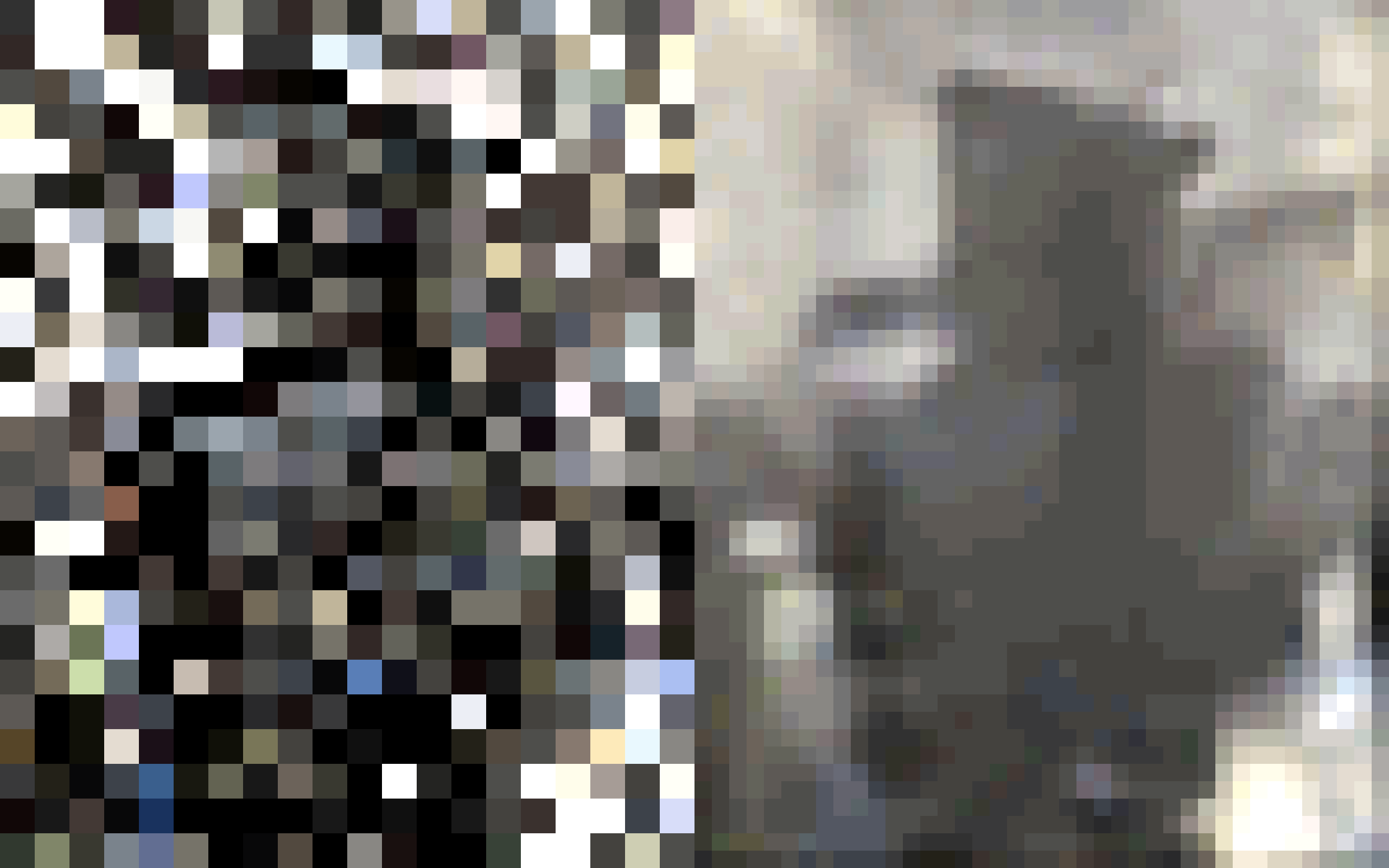

  • Denoising by default with Intel Open Image Denoise (OIDN): The Intel ® Open Image Denoiser imager is now added by default to new scenes (MTOA-1787)

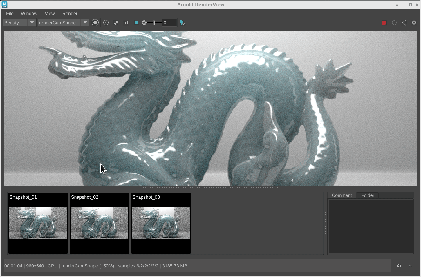

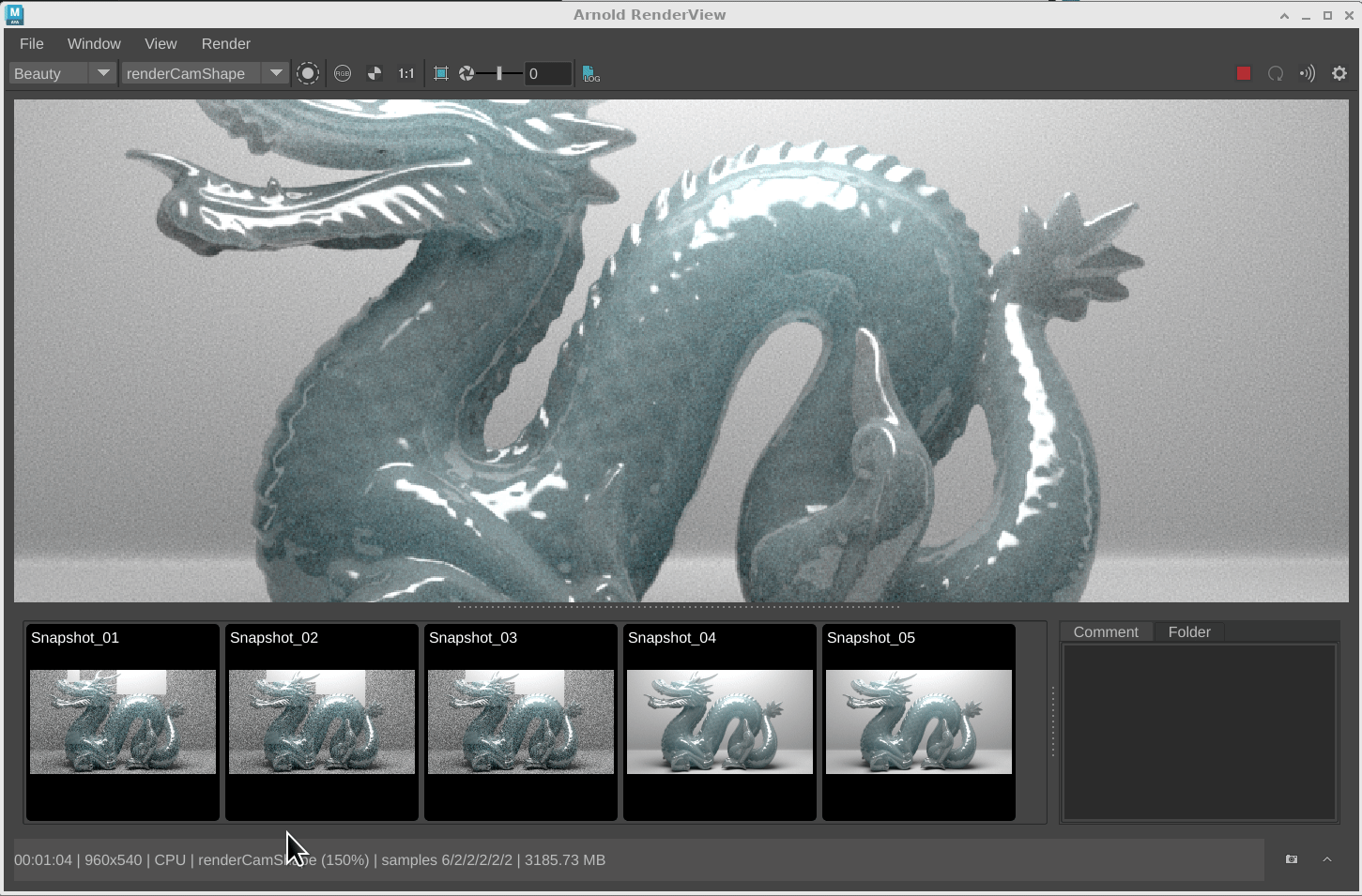

  • Improvements to the Arnold Render View Snapshots: The snapshot workflow and interface in the Arnold RenderView has multiple enhancements and behaviours.
    • Press the S hotkey in the Arnold RenderView to save a snapshot.
    • Improved UI for Snapshot buttons (ARNOLD-232)

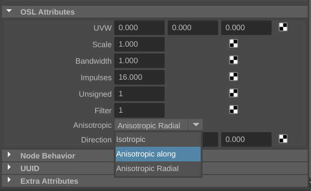

  • OSL Enum support in Attribute Editor : Shader parameters of type ENUM on the OSL code node create a combo box with the available options (MTOA-1781)

  • Update Intel Open Image Denoise (OIDN) to version 2.2.2: The updated denoiser has 10% better performance on CPU, includes some critical bug fixes, and handles high-frequency details better. (ARNOLD-14772)
  • OptiX denoiser runs on progressive negative AA passes: The OptiX denoiser imager now denoises the low-resolution progressive passes (renders with AA < 0). This should result in higher quality feedback in IPR. (ARNOLD-11487)
