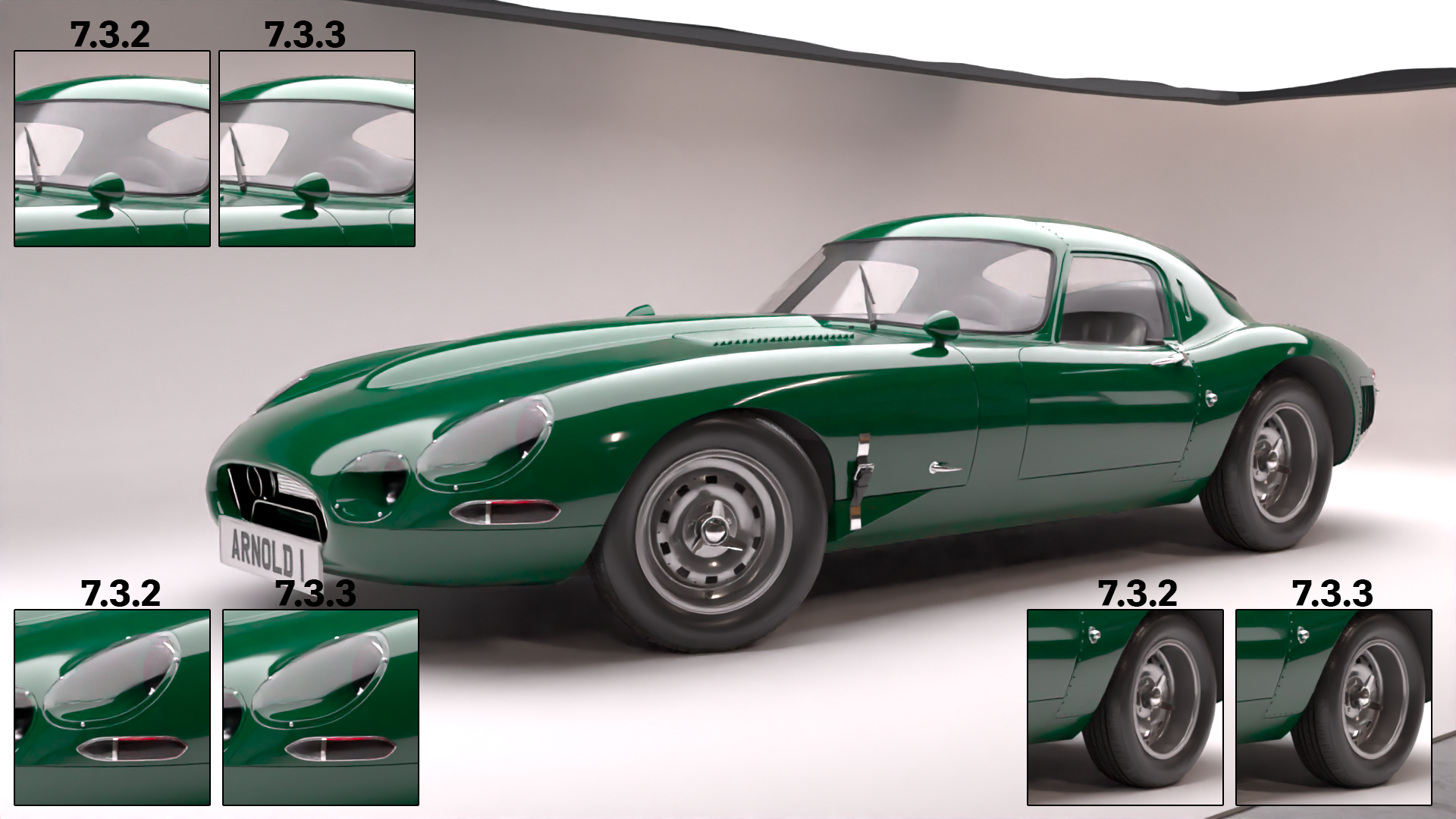

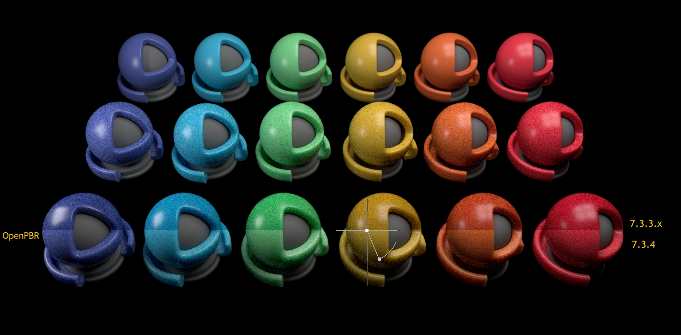

    • View-dependent coat absorption: The coat lobe now more accurately models the absorption tinting at grazing angles, producing a slightly more realistic look. (ARNOLD-15377)

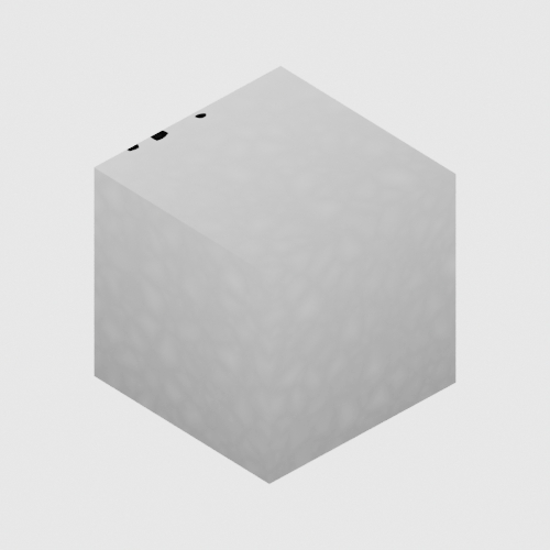

  • SSS color matching: The SSS model has been tuned to ensure that the color of dense SSS more closely matches the supplied subsurface_color, as required by the OpenPBR specification. (ARNOLD-15328) The following images compare diffuse base color with the subsurface colors of Standard Surface and OpenPBR Surface:
    • top row: diffuse with a given base_color
    • middle row: Standard Surface (dense) SSS, with same color assigned to subsurface_color
    • bottom row: OpenPBR (dense) SSS, with same color assigned to subsurface_color

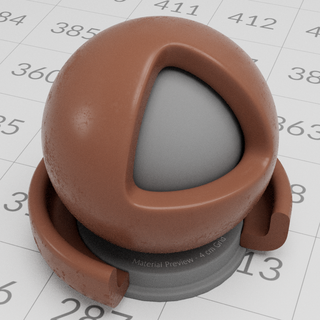

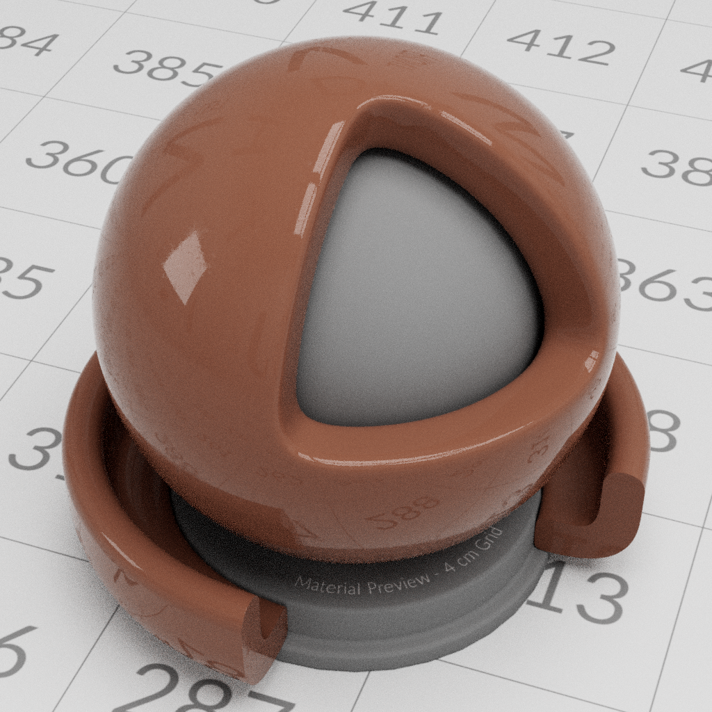

  • OpenPBR Surface: A new openpbr_surface shader implements the OpenPBR specification. OpenPBR Surface is an evolution of Standard Surface, developed in collaboration with Adobe and the Academy Software Foundation. It introduces many improvements, in particular a better sheen/fuzz model and improved metal reflectivity parameterization. (ARNOLD-13385)
image courtesy of Nikie Monteleone

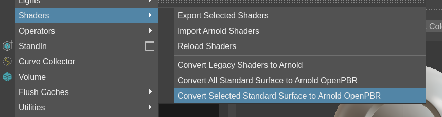

  • OpenPBR Workflow Tools:

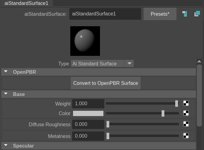

    • Tools have been added to help convert aiStandardSurface to aiOpenPBRSurface (MTOA-1829)

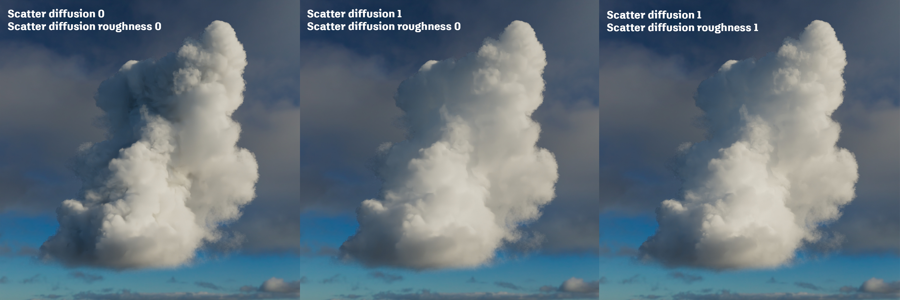

  • Scattering diffusion in volumes: Two new parameters in standard_volume improve how light is scattered in volumes. Using those parameters can help achieve high-scattering looks with fewer volume bounces and without adding energy. (ARNOLD-14482)
    • scatter_diffusion accelerates scattering in volumes.
    • scatter_diffusion_roughness accelerates scattering further on anisotropic volumes and can help achieve realistic looking clouds with fewer bounces.
    • gain and bias curves can further tweak the effect of both parameters

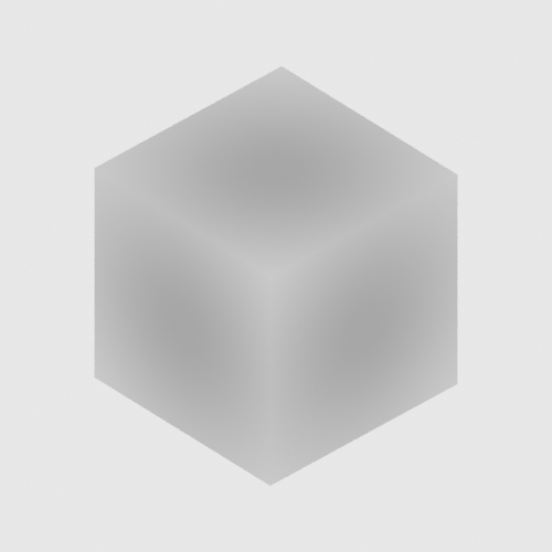

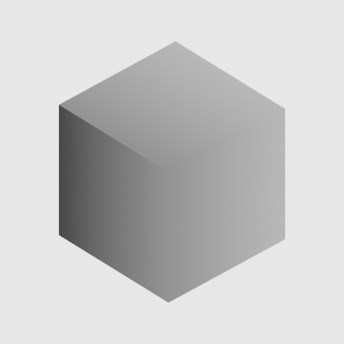

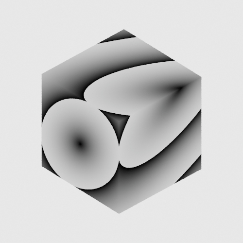

  • 3D ramp modes: Ramp shaders have three new modes: 3d_linear, 3d_spherical, and 3d_cylindrical. These modes calculate the ramp input from the distance between the shading point and a user-defined reference point or line. (ARNOLD-15051, ARNOLD-15196)
  • Ramp offset: Ramp shaders can now offset the input value, which allows you to add noise to the ramp. (ARNOLD-15052, ARNOLD-15197)

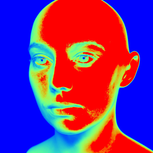

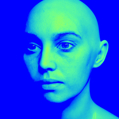

  • Heatmap Imager Mode: The tonemap imager now has a heatmap mode that creates a spectrum based on a looked-up AOV quantity. The color ranges from blue (at minimum) to red (at maximum). (ARNOLD-15123)

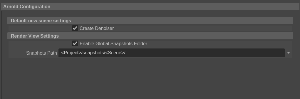

  • User preference for snapshots folder: There is a new user preference for the snapshots folder. You can override this by setting the environment variable ARNOLD_SNAPSHOTS_FOLDER (MTOA-1934)
