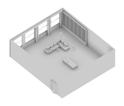

Ambient occlusion and direct light render combined using post-processing software
An alternative technique to lighting a room is to use Ambient Occlusion. A typical workflow is to composite the Ambient Occlusion render onto a Diffuse rendered image that does not have any GI Diffuse rays. The advantage is that it is typically faster to render and can give more creative control when compositing. You will also not need to add any GI Diffuse or GI Glossy rays to the scene. However, it is not a physically accurate method and some experience with compositing is required to fine-tune the final look.

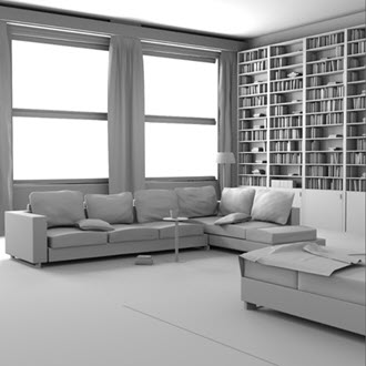

Ai Ambient Occlusion shader
  • Start by creating an Ai Ambient Occlusion shader and assign it to the room geometry. Increasing the Samples of the Ambient Occlusion shader to around 6 will reduce any noise associated with this shader.
  • Render the scene using the Ambient Occlusion shader. It should look like the image below:
Rendered using only the Ai Ambient Occlusion shader

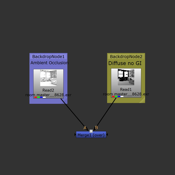

Composite
  • Open both renders in Nuke. Create a merge node and connect the Ambient Occlusion render to the 'A' input and the Direct light to the 'B' of the 'merge' node. Make sure the 'Operation' is set to 'Over'. Adjust the 'mix' to around 0.5. You should notice the Ambient Occlusion appear in the black areas of the 'Direct light' image. It should be obvious that we are in effect 'cheating' the use of bounced light using Ambient Occlusion.
Ambient occlusion render merged with diffuse render (no GI)
