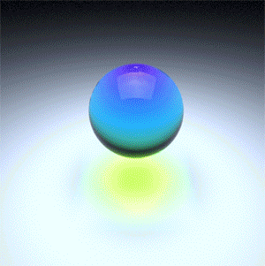

  • Assign a standard_surface shader to the polygon mesh that we want to generate the refractive caustics. We are going to make this a glass shader.
  • Lower the diffuse value to 0. Increase the specular_weight to 1 and lower the specular_roughness to 0. Increase the transmission_weight to 1 and change the IOR to that of glass (1.5).
  • Next, we will add a colored tint to the shader. Add some color to the transmission_color of the glass standard_surface shader.

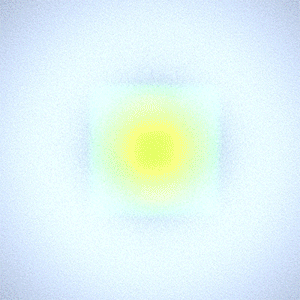

Refractive Caustics
To view refractive caustics through our glass, we must enable them in the standard_surface shader that is assigned to our glass mesh. caustics can be found under Advanced. Enable it.
You can see the difference when enabling caustics in the images below.
Caustics: Disabled Caustics: Enabled
Noise
To reduce noise in the caustics, you must increase the number of diffuse samples. The animations below show the difference between rendering caustics with three and six diffuse samples. Be careful when using this attribute as the render times will increase dramatically when you increase this value.
diffuse samples: 3 diffuse samples: 6 (much longer to render).
