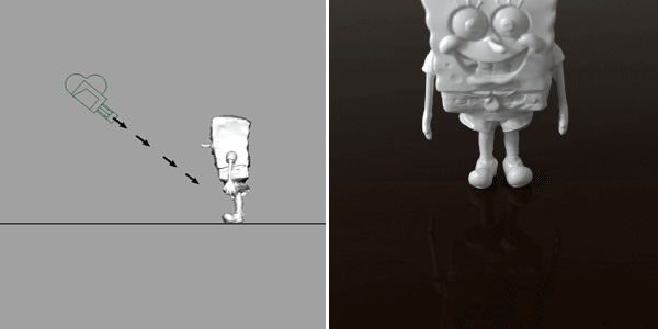

BRDF
A bidirectional reflectance distribution function (BRDF) describes the reflectance properties of a surface by specifying the amount of radiance incident from one direction that is reflected into another direction, with respect to the surface normal.
The main characteristics of a physically plausible BRDF are the symmetry between the incident and reflected directions (Helmholtz reciprocity) and that the total reflected power for a given direction of incident radiation is less than or equal to the energy of the incident light (Energy conservation).
A Specular BRDF model is view dependant and can take into account anisotropy and Fresnel effects at grazing angles. Arnold uses a Cook-Torrance BRDF.

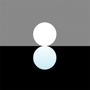

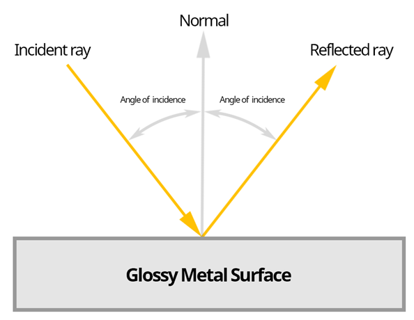

The light ray that hits a surface is called the Incident Ray and the angle that at which it hits is called the Angle of Incidence (as shown in the figure below). Light energy reflected back must be less than or equal to light incoming to a surface (we cannot "add" light). On the surface, the ray is either reflected or refracted, and it can eventually be absorbed by either medium.
Angle of incidence, incident, and reflected rays

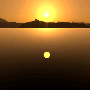

The Fresnel effect is named after the French physicist Augustin-Jean Fresnel who first described it. This effect states that the strength of reflections on a surface is dependent on the viewing angle. The amount of reflection increases on surfaces viewed at a glancing angle.
When IOR is greater than 1 in the Standard Surface shader, the reflectance of the object will be view dependent and vary obeying Fresnel equations. The Standard Surface shader uses Schlick's approximation of the fresnel equations and can be controlled by using the IOR of the material. At low values, the material behaves as a perfect dielectric, like plastic. With higher values, the material becomes a near-perfect conductor, or metallic surface.

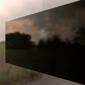

Fresnel is present in all materials in some form, being the most common examples glass and water. The example below shows the effect of fresnel on a wooden table. Notice how the reflection on the table appears more reflective as the camera's viewing angle becomes shallower.
Variation of a Specular BRDF with respect to the view direction

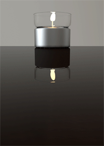

In the example below the cube has a standard_surface shader assigned to using IOR. The Fresnel effect is visible. The specular glossy reflection appears brighter when the camera's viewing angle becomes shallower.

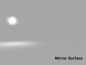

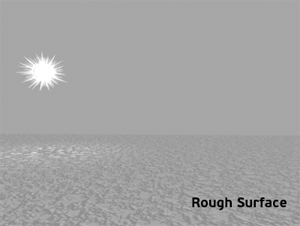

The animations below show how surface roughness can affect specular reflections.
In the examples below, you can see that the specular reflection appears stretched when the surface becomes 'bumpy' or 'rougher'.
