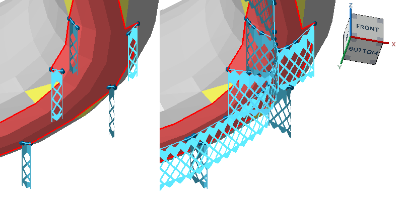

Offset to border
This parameter affects the length of the skeletal reinforcements in narrow cluster sections. The skeletal polyline is extended towards the wider portions of the cluster until its end is at least this distance away from the closest point in the cluster's contour.
Up to 10 mm

Demonstrating Offset to border values on the underside of the default Elliptical torus from the part library: 1.5 mm (left), 10 mm (right)
