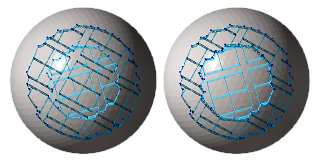

This sphere was supported with a script that included two actions with different values for cluster detection each. The smaller cluster was determined first (with a critical angle smaller than the larger cluster's). Left: Duplicate support tolerated. Right: Avoided.
Note: Technically, this compares the detected clusters first before actually generating any supports: If you have two support actions that both detect effectively the same clusters, the second action (set to avoid duplicate clusters) does still not generate any supports even when there would be space in the cluster to fit. For those cases, set this to tolerate duplicate support and also set Keep distance to support to Yes.

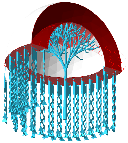

The top half of a hollow sphere, containing a concave and convex cluster. Each cluster is covered by a different action with its own detection settings each.
