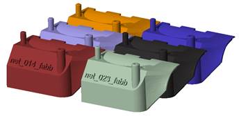

An example for setting up a list generation
The labeled parts as generated using the example.
