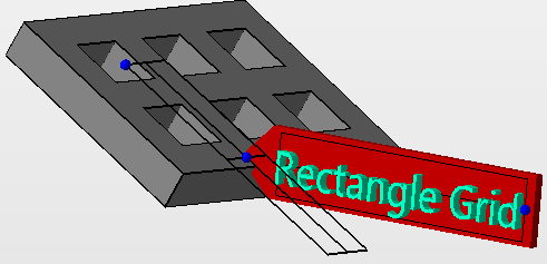

Dynamically generated breakaway tags with text
- Select the part to be labeled.
- Click .
- Click on the part to place a template for the label.
- Click and drag the blue nodes of the template to adjust the position, rotation, and size of the tag.
Tip: Use the Ctrl key and the corner node to rotate the tag without adjusting the size. Use the Shift key and the corner node to adjust the size without adjusting the orientation.
- Click and drag the blue node on the tag to adjust the orientation of the shield relative to the surface the label is applied on. Any movement of this node is always performed parallel to the screen. Change the camera perspective to rotate the tag accordingly.
- Click Apply to create the text label.
- Click Yes to remove the old part or No to keep the old part and the newly labeled part.
