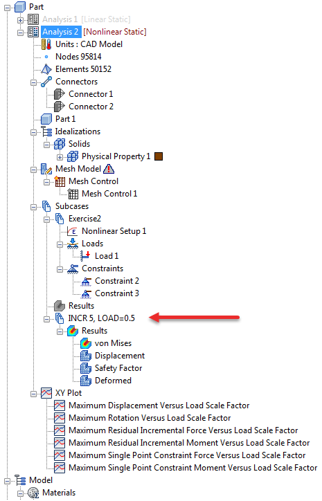

Load and Display Intermediate Results: This option works in conjunction with Generate Intermediate Results and thus, is only available when that option is checked. The incremental results are automatically loaded into the tree under Subcases and can be viewed until the next increment has been solved. This is shown in the example below.
