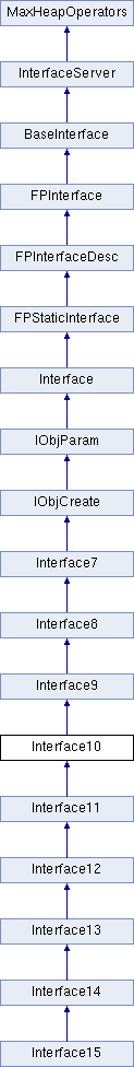

Extends Interface9 Client code should retrieve this interface using GetCOREInterface10.
Inheritance diagram for Interface10:Public Types | |
