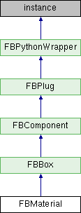

Material class.
Inheritance diagram for FBMaterial:Public Member Functions | |
