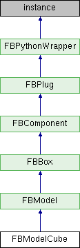

#include <mobu-python-api.h>
Cube model class.
