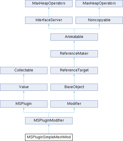

Inheritance diagram for MSPluginSimpleMeshMod:
