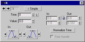

Bezier Float controller properties.
See Bezier Controller for descriptions of these parameters.
