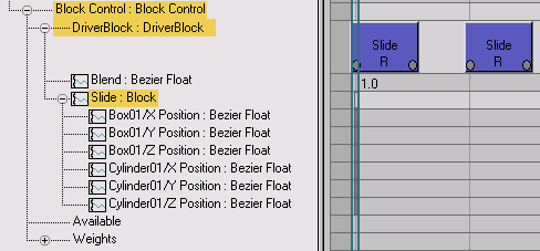

DriverBlock Subtracks
Below the main DriverBlock track are subtracks. The first of these is always Blend. The remaining subtracks are initially copies of the tracks used to create the block.
Blend track
Lets you animate the influence of the block. You can reduce the block's influence by creating Blend keys with values less than 1.0. Default=1.0.
Block-specific subtracks
Display the block name and its associated tracks. Initially these are copies of the tracks used to create the block. You can edit keys on these tracks to change the block's behavior.

Example continued: To use a block:
  1. In the Dope Sheet Key window, right-click the DriverBlock track.
    A pop-up menu displays the name of blocks already created; in this case, it's just the one you created in the preceding procedure.
  2. Click the name of the block you created earlier.
    The block is displayed in the Key window.
  3. Drag the Block to start at frame 20, and click Play.
    The animation repeats at frame 20.

DriverBlock Track
Displays in Track View after you assign a Driver Block controller to an available track.
You can right-click the track in the Key window. This displays a pop-up menu that shows the name of blocks that have been created. Choosing a block inserts the block into the DriverBlock track. The dialog also has an entry, Properties, that displays the Driver Block Parameters dialog.
In the DriverBlock track, inserted blocks display as colored rectangles. The name of the block appears at the center. In the lower left and right corners are keys that indicate the beginning and end of the block's animation. Below the name of the block is the letter “R” for relative, or “A” for absolute. Click and drag the center of a block to move it in time. Select a key in the corner of a Block to move one edge of the block (scale time).
