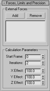

Forces Limits and Precision rollout
External Forces group
Add
Click this button, and then select one or more space warps in the Forces category that are to affect the object's motion. To finish adding space warps, click Add again, right-click in a viewport, or press Esc.
Remove
Removes highlighted space warps from the list.
[List]
Lists all spring space warps by name.
Calculation Parameters group
Start Frame
The frame at which the Spring controller first takes effect. Default=0.
Iterations
The accuracy of the controller application. If you get unexpected results, try increasing this setting. Default=2. Range=0 to 4.
X/Y/Z Effect
These settings let you control the percentage of the effect on the individual world axes. Default=100.0. Range=0 to 1000.0.
