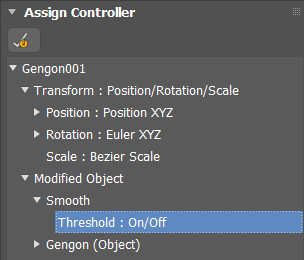

Assign and choose On/Off from the Assign Controller dialog. Click OK. The entire track region is filled by a blue bar. This means that Visibility is on throughout the animation.

You assign the On/Off Controller in Track View.
