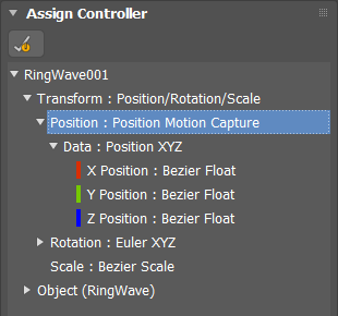

Example: To use your mouse as an input device to animate the position of a box:
  1. Create a box.
  2. On the Motion panel Assign Controller rollout, select the position track for the box in the list window, and then click (Assign Controller).
  3. On the Assign Position Controller dialog, click Position Motion Capture, and then click OK.
  4. On the Motion Capture dialog, click the X Position button, choose Mouse Input Device, and then click OK.
    Note: You can open the Motion Capture dialog by clicking the Position track in the Controller list and then right-clicking and choosing Properties.

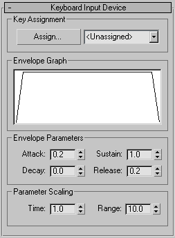

Keyboard Input Device rollout
This rollout lets you assign most keyboard keys to drive the animation.
Assign
Click and then press any key. The assigned key is displayed in the list window at right.
List
Open the list to select a key.
Envelope Graph group
The Envelope Graph group displays a representation of the amplitude curve over time.
Envelope Parameters group
These options specify the time the envelope of the action takes effect. This relates to the duration of pressing and releasing the key.
Attack
Specifies the time, after pressing the key, for the value to reach its maximum level.
Decay
Specifies the time, after having reached maximum, for the value to fall to that specified by the Sustain spinner.
Sustain
After the Attack and Decay, specifies the value sustained until you release the key.
Release
After releasing the key, specifies the time for the value to fade out to zero.
Parameter Scaling group
Provides controls for setting the scale of the envelope and the range of the output value.
Time
Specifies the scale of the Attack, Decay, and Release parameters. The value represents the number of seconds for 1 unit. For example, if this value is 1.0, then an Attack value of 1.0 equals 1 second.
Range
Sets the maximum output value of the controller.
Note: This controller ignores the state of the Ctrl, Alt, and Shift keys.

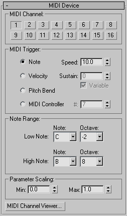

MIDI Device rollout
MIDI Channel group
This group contains 16 buttons. You can assign a channel to your MIDI device.
MIDI Trigger group
Here, you define the type of MIDI event (message) that will drive the motion. There are four options; Note, Velocity, Pitch Bend and MIDI controller.
  • Note Turn on to let the note number or pitch define the output value. The value is derived from where the note falls within the Note Range, specified in the group below. When the note is at the bottom of the range, the value takes on the Min value specified in the Parameter Scaling group. When the note is at the top of the range, the value takes on the Max value from the same group. Anything in between is interpolated between the Min and Max values. (Note that Min doesn't have to be less than Max.) The generated value will slide around as different keys are pressed. The harder a key is pressed, the faster the value changes.
    Speed Defines how fast the value changes as keys are pressed.
  • Velocity
    Determines the output value based on the velocity that the note pressed. The notes set in the Note Range group specify which notes are valid to press. The value takes on the Min value until a key within the Note Range is pressed. When the key is pressed, the value approaches the Max value based on how hard the key was pressed. (The value actually travels along a parabola toward the Max value.)
    Sustain Defines how long it takes the value to move through the parabola.
    Variable Sustain duration is scaled by how hard the key is pressed.
  • Pitch Bend Value is defined by the MIDI instrument's pitch bend knob. The Note Range doesn't apply in this case and is not available.
  • MIDI Controller Specifies a note event when you're hooked up to a different type of MIDI controller than the typical keyboard. For example, if you're using a MIDI slider box, you would select the MIDI Controller option, and then use the # spinner to specify the note event for the specify slider.
Note Range group
Choose Note or Velocity, and then set the note range here. A value is derived from where the note falls within the Note Range.
Low Note
Set a note and octave for the lower range.
High Note
Set a note and octave for the higher range.
See Note parameter in the MIDI Trigger group, above.
Contains the Min and Max spinners, which specify the range of generated values. See Note and Velocity above.

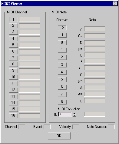

MIDI Channel Viewer
Displays a dialog that lets you test your MIDI device to see which MIDI channel is receiving events and which notes are being triggered.
Midi Viewer Dialog
MIDI Channel group
Provides a column of 16 buttons and progress bars representing the 16 MIDI channels. Select the channel where you want to view note activity. The channel progress bars light up when any channel has an event.
MIDI Note group
The 11 Octave buttons let you select which octave you want to view. When a note is played in that octave, a corresponding progress bar lights up in the Note column.
MIDI Controller
When using a different type of MIDI controller, such as a slider box, you can specify a note event, and then watch the corresponding progress bar light up when you activate that event. (You can find the correct note number by activating the event while watching the Note Number field in the group below.)
Channel
Displays the currently selected channel. This is one of four text fields that display all of the values being generated by the MIDI device as you activate an event.
Event
Displays the type of MIDI event being sent. For example:
Note On: 9
Note Off: 8
Pitch Bend: 14
MIDI Controller: 11
Velocity
Displays the velocity, which has a different meaning depending on the event. For the most common event, a note being pressed, this value represents the velocity at which the key was struck. Other events, however, might generate a continuous value. For example, a pitch bend event transmits the position of the pitch bend.
Note Number
Displays the corresponding note number for the event. When you're using a non keyboard MIDI device, such as a slider box, you can use this to identify the note number of a specific slider.
