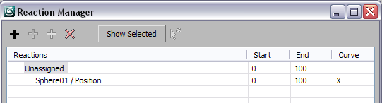

  5. On the Assign Controller rollout, click (Assign Controller).
  6. On the Assign Position Controller dialog, click Position Reaction to highlight it, and then click OK.
    This opens the Reaction Manager dialog. The Reactions list shows that the sphere's position is assigned as a driven object, and a driver entry exists but no motion is assigned to it. A Reaction controller uses a driver object's motion to control any number of driven objects.
  7. Right-click the “Unassigned” entry at the top of the Reactions list. From the menu, choose Replace Driver.
    This places you in a Pick mode where you can choose a motion track from any object in the scene to act as driver.

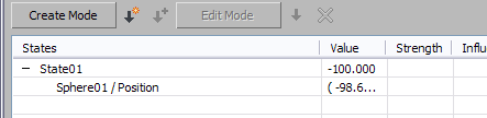

    The “Unassigned” text is replaced by a driver track labeled “Box001 / X Position”.
    Also, a new state, State001, appears in the States list, below the Reactions list.
    This is an example of the basis of the control mechanism used by the Reaction controller: For each driver/driven object combination, you can specify any number of states defined by values for the driver and driven tracks. The first state, created automatically when you added the driver, specifies that when the box is at –100 on the X axis, the sphere should be at (–100,0,50). In this case, you're controlling three parameters (the sphere position on all three axes) with one (the box position on the X axis). More typically you'd use one-to-one driver/driven-parameter ratios.

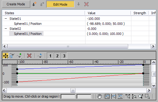

  13. On the Reaction Manager dialog, click the Sphere001 / Position entry under State002 to highlight it, if necessary, and then click the Edit Mode button.
  14. Position the sphere at (0,0,100).
    The position updates in the Sphere001 / Position line under State002. Also, the Reaction Manager graph shows the change in values of the driven object's(sphere) X and Z position values as the driver box's X position changes. On the graph, as in Track View, red=X, green=Y, and blue=Z.
  15. Click the Edit Mode button again to turn it off, and then scrub the time slider.
    As the box moves between frames 0 and 50, the sphere rises to the position specified in the second state.
