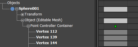

In Dope Sheet mode, the Point Controller Container is displayed as a track with green keys in Track View. Sub-tracks below the main track contain all the animated vertices, control points, and vectors.

    3ds Max opens the Track View - Dope Sheet. At the top of the Controller window, you can see the tracks for the sphere.
  7. Expand all the Sphere tracks in the Track View hierarchy.
    Track View displays the Point Controller Container track, with tracks for the animated vertices below it.

In Track View – Dope Sheet mode, clicking a point controller key (green) highlights all sub-keys at that frame.
If hundreds of vertices are animated, collapse the track so that only the top track is visible. Moving a green key moves all of its sub-keys.
