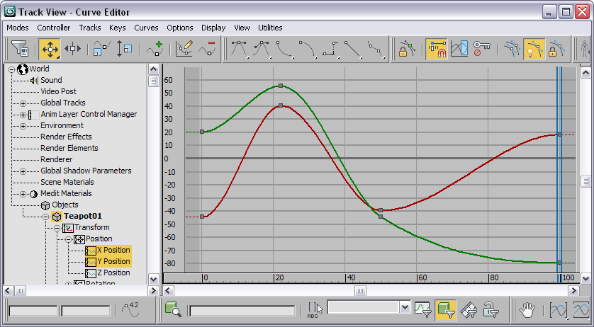

- Start with an animated object, and open the Curve Editor.
In this example, the teapot position was animated on the X axis between extents of about –45 to 40, and on the Y axis between extents of about –80 and 54.

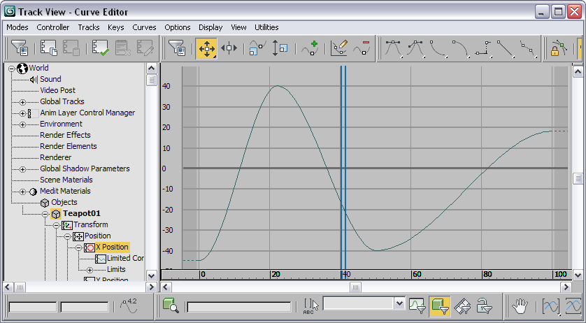

- Expand the track.
The hierarchy contains a child track, named Limited Controller, and a new, expandable child branch named Limits.
- Click the X Position track and then the Limited Controller track to compare them.
Because the original X-axis movement falls within the default limits, the two tracks are identical.

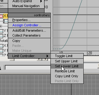

- Scrub the animation until the X-axis position is where you want to set a limit. In this example, the position is about -20, where we'll set a lower limit.
- Highlight the X Position track, and then right-click and from the right-click menu choose Limit Controller
Set Lower Limit.
The graph curve is now clipped below the lower limit. When you scrub the animation, the object doesn't move beyond that position.
- Again scrub the animation, stop where you want to set the upper limit, right-click the X Position track, and choose Limit Controller
Set Upper Limit.
In this example, we've set it at about 13. The graph curve is now clipped above the upper limit and below the lower limit. The resulting motion is likewise constrained.

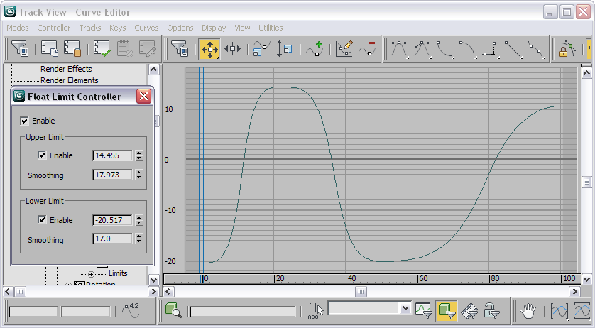

Finally, we'll cover the Smoothing Buffer settings. By default, sharp corners are created wherever a curve is limited, causing abrupt changes in motion. You can smooth off these corners with the Smoothing Buffer parameters, resulting in more natural-looking motion.
- Highlight the X Position track, and then right-click it and choose Properties.
This reopens the Float Limit Controller dialog.
- Use the Upper Limit group
Smoothing Buffer spinner to increase the Smoothing Buffer value as far as it can go.
As you increase the value, the corners of the upper limit on the graph become smoother.
Note that there's an upper limit to this value; in this case, it's 34.973. This limit is determined by the values of the other three settings on the dialog.
- Try increasing the Lower Limit group
Smoothing Buffer. It's not possible with the upper smoothing value at its maximum.
- Decrease the upper smoothing value, and then increase the lower smoothing value.
Now you get smoothing at both the upper and lower limits.

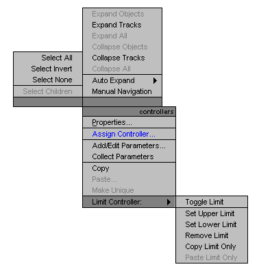

Limit Controller right-click menu
To access the Limit Controller right-click menu, highlight a Limit Controller track in the Track View hierarchy, and then right-click the track and move the cursor to the Controllers quadrant
Limit Controller menu item.
- Toggle Limit
- Turns the Limit controller on and off. This is the same as the Enable checkbox on the Float Limit Controller dialog.
- Set Upper Limit
- Sets a value/key in the Upper Limit track at the current frame equal to the value at the current frame of the limited track. If there is only one key, the value of the limit is constant over time.
- Set Lower Limit
- Sets a value/key in the Lower Limit track at the current frame equal to the value at the current frame of the limited track. If there is only one key, the value of the limit is constant over time.
- Remove Limit
- Deletes the Limit controller, restoring the original controller without limits. The deleted Limit controller is copied to the clipboard.
- Copy Limit Only
- Copies only the Limit values and ignores the limited controller of the highlighted track.
- Paste Limit Only
- Applies only the copied Limit values, or adds a Limit controller with the copied values if one doesn't exist, while retaining the values of the original limited track.
As with pasting copied controller tracks, you can paste the Limit values as a copy or an instance of the copied Limit controller, with the option to replace all instances of the paste target.
