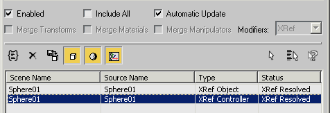

- You can create an XRef object, which automatically nests the source object's Transform controller in an XRef controller. The XRef Objects dialog's
XRef Entities list lists both XRefs as separate entries.

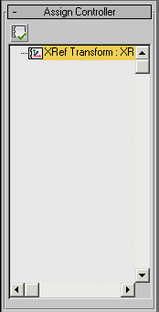

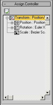

Motion Panel, click Parameters, and open the Assign Controller rollout.
- Highlight the Transform track in the Assign Controller list.
- Click
(Assign Controller), and then select XRef Controller from the Assign Transform Controller dialog.
- In the Open File dialog, navigate to the file from which to externally reference the transform controller and then click Open.
- Use the XRef Merge dialog to designate the object whole transform controller you want to XReference.
3ds Max references the scene object's transform controllers from the external object's controllers.
Tip: You can also XReference a different controller from either another file or another object via the Parameters rollout of the XRef controller.
Object's Transform Position highlighted.
Object's Transform Position XReferenced.

- Right-click the XRef Controller entry in the XRef Entities list of the XRef Objects dialog.
- From the contextual menu, choose Reset PRS Offset.
This removes the sphere's local offset, which now returns to its original [0,0,0] position.
