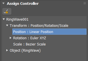

To assign a Linear controller:
  1. Select an animated object.
  2. On the Motion panel Parameters Assign Controller rollout, click the Position track in the list window.
  3. Click (Assign Controller), and then choose Linear Position from the Assign Controller dialog list.
    The animated object now has a mechanical motion.
    You can also assign this controller in Track View.
