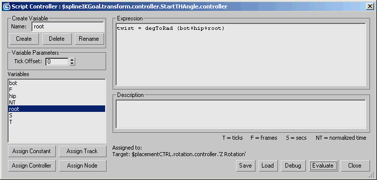

Interface
Assigning a Script controller automatically opens a Script Controller dialog where you can enter a script. You can open the dialog subsequently by right-clicking the track on the Motion panel or in the Track View hierarchy and choosing Properties, or clicking the Properties button on the Track View toolbar.
Tip: You can resize the dialog by dragging an edge or a corner.
Create Variable group
Name
Lets you enter and edit the name of user variables.
Create
Creates a variable and adds it to the Variables list.
Delete
Removes the highlighted variable from the Variables list. You can also delete a variable by typing its name into the Name field and then clicking Delete.
Rename
Renames the highlighted variable.
Variable Parameters group
Tick Offset
Specifies a time offset in ticks for the current variable. When the script is evaluated, the variable's value is set from the current time plus the Tick Offset value.
Note: The Time Offset has no effect on variables that are assigned a constant.
Variables list
Lists all available variables in the controller. The following pre-defined constant variables are available in every script Controller and cannot be deleted or renamed:
  • F the current time in frames
  • NT the normalized time
  • S the current time in seconds
  • T the current time in ticks
Assign Constant
Opens a dialog that lets you assign a constant to the highlighted variable.
  • Value expression Enter any MAXScript value or expression (such as an integer, a float, an array, and so on).
  • Value expression result Displays the results of the expression above.
  • Evaluate Analyzes the expression at the current time.
  • OK Assigns the value expression result to the current variable.
  • Cancel Disregards the current value expression result and closes the dialog.
Assign Track
Lets you assign a track to the highlighted variable.
Assign Controller
Lets you assign a controller to the highlighted variable. The controller's value is taken at the current time plus the variable's Tick Offset.
Assign Node
Lets you assign a node to the highlighted variable.
Expression window
Displays the expression to evaluate. You can edit the text in this window.
Description window
In this text window, you can enter comments about how the controller works, how to use it, and so on.
Save
Click to save the script to a MAXScript (.ms) text file.
Load
Click to load a script from a MAXScript (.ms) text file.
Debug
Opens the Script Controller Debug Window, which displays the value of all variables used in your script.
Evaluate
Evaluates the script expression. The evaluation is computed for the current position of the time slider.
Close
Compiles and checks the controller script for errors. If no errors are found, the dialog is closed. Any problems result in a query box asking whether you want to revert the expression to the original value of the current track and close the dialog (OK), or to return to editing the expression (Cancel).
