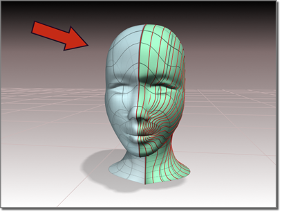

To create a mirror surface:
- In the NURBS toolbox, turn on
(Create Mirror Surface). - On the Mirror Surface rollout, choose the axis or plane you want to use.
- Click the surface you want to mirror, and drag to set the initial distance of the mirror surface.
The mirror surface is created. A gizmo (yellow by default) indicates the direction of mirroring. Transforming the mirror surface's gizmo changes the orientation of the mirror, letting you mirror along an axis that isn't aligned with a local coordinate axis.
The Flip Normals control lets you flip the surface normals at creation time. (After creation, you can flip normals using controls on the Surface Common rollout.)
