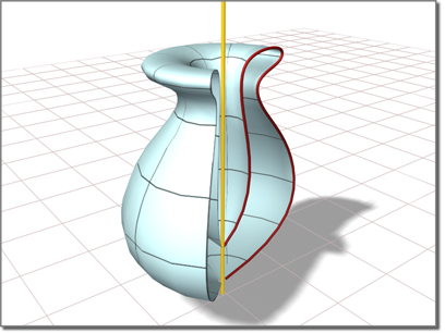

To create a lathe surface:
- In the NURBS toolbox, turn on
(Create Lathe Surface). - Click the curve to lathe.
The lathe surface rotates about the NURBS model's local Y axis. The initial lathe amount is 360 degrees. A gizmo (yellow by default) indicates the axis of the lathe. Transforming the lathe surface's gizmo changes the shape of the lathe, and lets you lathe around an axis that isn't aligned with a local coordinate axis.

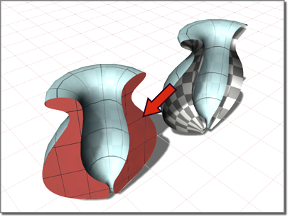

Sets the angle of rotation. At 360 degrees (the default), the surface completely surrounds the axis. At lower values, the surface is a partial rotation.
A partial lathe (degrees=225)

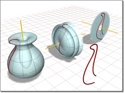

- X, Y, and Z
Choose the axis of rotation. Default=Y.
X, Y, and Z rotations of the same curve

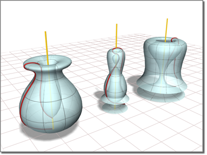

These buttons position the axis of rotation relative to the curve.
- Min
(The default.) Locates the lathe axis at the curve's negative local X-axis boundary.
- Center
Locates the lathe axis at the curve's center.
- Max
Locates the lathe axis at the curve's positive local X-axis boundary.
Min, Center, and Max lathes of the same curve

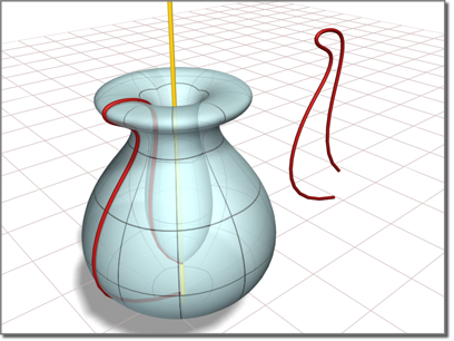

- Start Point
Adjusts the position of the curve's start point. This can help eliminate unwanted twists or "buckles" in the surface.
This control is disabled if the curve is not a closed curve.
The start point is displayed as a blue circle.
