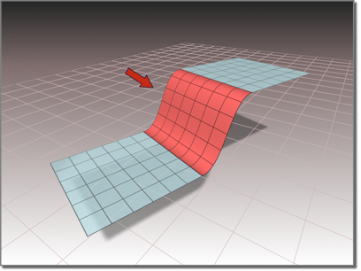

A blend surface connects one surface to another, blending the curvature of the parent surfaces to create a smooth surface between them. You can also blend from a surface to a curve, or from a curve to a curve.
  • Select a NURBS object. > Modify panel > Create Surfaces rollout > Dependent Surfaces group box > Blend
  • Select a NURBS object. > Modify panel > NURBS toolbox > (Create Blend Surface)
Blend surface connecting two other surfaces
Procedures
To create a blend surface:
    The NURBS object must contain at least two surfaces, two curves, or a surface and a curve.
  1. In the NURBS toolbox, turn on (Create Blend Surface).
  2. Click one surface near the edge that you want to connect. The edge that will be connected is highlighted in blue. Drag to choose the other edge you want to connect. When the edge you want is highlighted, click and then drag to the other surface. The edge of the other surface is also highlighted in blue. Drag on the other surface to choose the edge to connect, and then release the mouse button to create the blend surface.
    The surface that owns the highlighted edge is highlighted in yellow, to help you distinguish which edge you are choosing when two surfaces have coincident edges.
    The blend surface is created. Changing the position or the curvature of either parent surface will change the blend surface as well.

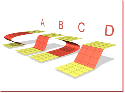

"Tension" affects the tangent between a parent surface and the blend surface. The greater the tension value, the more closely the tangent parallels the parent surface, and the smoother the transition. The lower the tension, the greater the tangent angle and the sharper the transition between parent and blend.
Tension 1
Controls tension at the edge of the first surface you clicked. This value has no effect if the edge is a curve.
Tension 2
Controls tension at the edge of the second surface you clicked. This value has no effect if the edge is a curve.
A. Tension 1=0, Tension 2=10
B. Tension 1=1, Tension 2=1
C. Tension 1=10, Tension 2=0
D. Tension 1=0, Tension 2=0

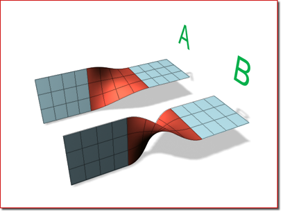

Flip End 1 and Flip End 2
Flip one of the normals used to construct the blend. A blend surface is created using the normals of the parent surfaces. If the two parents have opposing normals, or if a curve has the opposite direction, the blend surface can be shaped like a bow tie. To correct the situation, use Flip End 1 or Flip End 2 to construct the blend using a normal opposite the corresponding parent surface's normal.

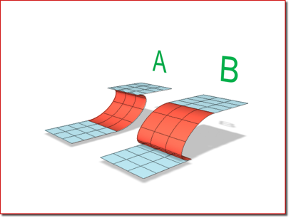

Flip Tangent 1 and Flip Tangent 2
Flip the tangent at the edge of the first or second curve or surface. Flipping the tangent reverses the direction in which the blend surface approaches the parent sub-object at that edge.
Flipping the tangent has no effect if the edge is a curve, unless the curve is a curve on surface.
When you blend to a CV or point curve on surface, the new blend surface is tangent to the surface on which the curve on surface lies. The Flip Tangent controls are especially useful in this situation.
A. Tangent 1 flipped
B. Tangent 2 flipped
