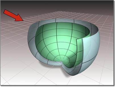

An Offset surface is offset a specified distance from the original along the parent surface's normals.
  • Select a NURBS object. > Modify panel > Create Surfaces rollout > Dependent Surfaces group box > Offset
  • Select a NURBS object. > Modify panel > NURBS toolbox > (Create Offset Surface)
Surface created as an offset
