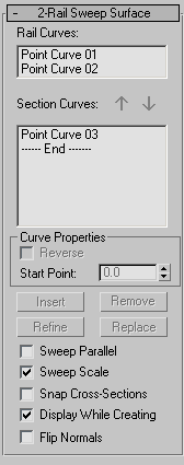

2-Rail Sweep Surface rollout (creation time)
- Rail Curves
Shows the names of the two curves you chose to be the rails.
- Section Curves
This list shows the names of the cross-section curves, in the order you click them. You can select a curve by clicking its name in the list. Viewports display the selected curve in blue.
- Arrow Buttons
Use these to change the order of section curves in the list. Select a curve in the list, and then use the arrows to move the selection up or down.
Curve Properties group
These controls affect individual curves you select in the Section Curves list, as opposed to properties of the sweep surface in general. They are enabled only when you have selected a curve in the Section Curves list.
- Reverse
When set, reverses the direction of the selected curve.
- Start Point
Adjusts the position of the curve's start point. This can help eliminate unwanted twists or "buckles" in the surface.
This control is disabled if the curve is not a closed curve.
While you're adjusting start points, a dotted blue line is displayed between them, to show the alignment. The surface is not displayed, so it doesn't slow down adjustment. When you release the mouse button, the surface reappears.
- Insert
(Disabled.)
- Remove
Removes a curve from the list. Select the curve in the list, and then click Remove.
- Refine
(Disabled.)
- Replace
(Disabled.)
- Sweep Parallel
When off, the rail curves define a ruled surface, and the cross sections describe lofting from this base ruled surface. When on, each cross section is associated with its best fitting plane. This plane moves along the rails and parallel to them. If the rails are curved, the plane can rotate. If the spacing between the rails changes, the section scales or stretches. In either case, the surface is blended from section to section along its entire length. Default=off.
- Sweep Scale
When off, the size of the plane is scaled only in the direction across the rails. When on, the plane is scaled uniformly in all directions. Default=off.
- Snap Cross-Sections
When on, cross-section curves are translated and scaled so they intersect both rails. The first cross section is translated to the start of the rails, and the last to the end of the rails. The cross sections in the middle are translated to touch the rails at the closest point to the ends of the cross-section curves. Default=off.
When Snap Cross-Sections is on, the sweep follows the rail curves exactly. This makes it easier to construct 2-rail sweep surfaces.
- Display While Creating
When on, the sweep surface is displayed while you create it. When off, the sweep can be created more quickly. Default=off.
- Flip Normals
Reverses the direction of the sweep's normals.

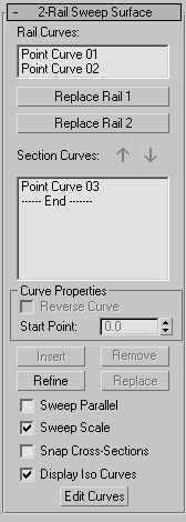

2-Rail Sweep Surface rollout (Modification time)
- Rail Curves
- Replace Rail 1 and Replace Rail 2
Let you replace the rail curves. Click one of these buttons, then in a viewport click the curve to use as the new rail.
- Section Curves
- Arrow Buttons
- Reverse
- Start Point
- Insert
Adds a curve to the section list. Click to turn on Insert, then click the curve. The curve is inserted before the selected curve. To insert a curve at the end, first highlight the "----End-----" marker in the list.
- Remove
- Refine
Refines the 2-rail sweep surface. Click to turn on Refine, then click an iso curve on the surface. (As you drag the mouse over the surface, the available section curves are highlighted.) The curve you click is converted to a CV curve and inserted into the sweep and the section list. As when you refine a point curve, refining a sweep can change the curvature of the surface slightly. Once you’ve refined the surface by adding a cross-section curve, you can use Edit Curves to change the curve.
- Replace
Lets you replace the selected curve. Select a curve in the list, click this button, then select the new curve.
- Sweep Parallel
- Sweep Scale
- Display Iso Curves
When set, the 2-Rail Sweep's V-axis iso curves are displayed as well as the U-axis curves used to construct the sweep. The V-axis curves are only for display. You can’t use them for surface construction.
- Edit Curves
Lets you edit the currently selected curve without switching to another sub-object level. Click to turn on Edit Curve. The points or CVs of the curve are displayed, as well as the control lattice if the curve is a CV curve. You can now transform or otherwise change the points or CVs as if you were at the Point or Curve CV sub-object level. To finish editing the curve, click to turn off Edit Curves.
Tip: When you edit curves in a 2-rail sweep, turning off display of the sweep itself can make the curves easier to see and improve performance as well. Use Ctrl+D (while the Keyboard Shortcut Override Toggle is on) to toggle display of dependent sub-objects, including sweeps.The sweep surface can deviate from the curve if you edit a curve in a sweep by increasing the weight of the curve CVs. You can work around this by refining the curve at the point where the surface deviates.
