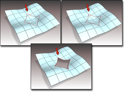

A multicurve trimmed surface is an existing surface trimmed by multiple curves that form a loop.

Creating a multicurve trimmed surface
When you create a multicurve trimmed surface, you create only one trimmed hole. If you want to create multiple holes, first create holes in the surface using other techniques, and as the final step create the multicurve trim.

  4. In the NURBS toolbox, turn on (Create A Multicurve Trimmed Surface).
  5. Click the surface to trim, then click each of the curves in the loop. Right-click to end creation.
    The Trim list shows the names of the curves you select. Flip Trim inverts the direction of trimming. Flip Normals lets you flip the surface normals at creation time. (After you have created the surface, you can flip normals using controls on the Surface Common rollout.)
