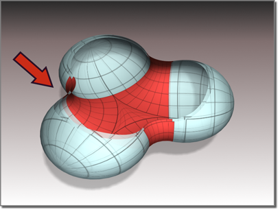

A multisided blend surface "fills in" the edges defined by three or four other curve or surface sub-objects. Unlike a regular, two-sided blend surface, the curves’ or surfaces’ edges must form a closed loop; that is, they must completely surround the opening that the multisided blend will cover.
Multisided blend between three other surfaces
