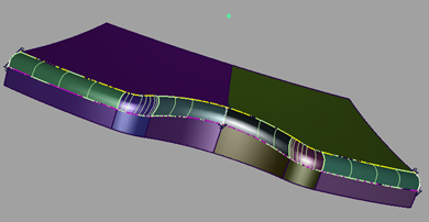

Profile Blend works in the same way as Freeform blend, but with an added curve(s) to define the profile shape. It does a similar job to the Rail tool, except:
  • Multiple boundaries can be used as rail curves.
  • There is no continuity option for the profiles, and less control over surface quality.

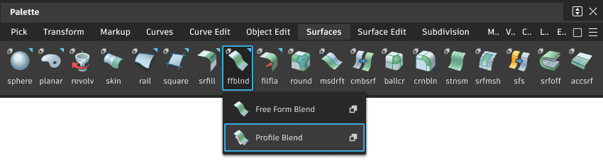

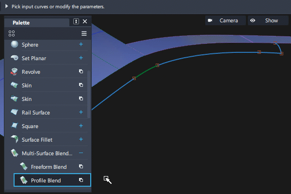

Access the tool from the Surfaces tool palette:

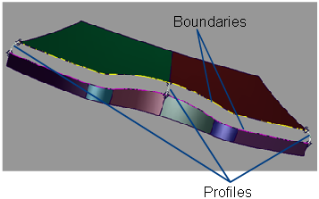

  1. Shift-select the Profile Blend tool.
  2. Select all the surface boundary curves.
    The first set of boundaries is highlighted in green, and the second set of boundaries is highlighted in yellow.
    Click the Accept button (or Space Bar as a shortcut).
    Note: If Chain Select is turned on in the option window, selecting the boundary of one surface will also select all other boundaries that are tangent continuous with it.
  3. Select all the profile curves that will define the transitional surface.
    The selected profile curves are highlighted in red.
    Click the Update button when you’re finished selecting the profile curves.
