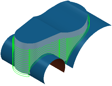

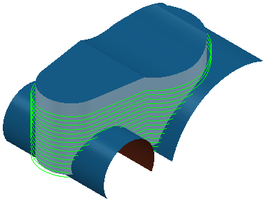

Use the Multiple cuts page to allow multiple passes down the tool axis.
Mode —Select a mode to determine how the multiple passes are created.
  • Off — Select to create a single toolpath.
  • Offset down — Select to offset the top cutting path, moving down.
  • Offset up — Select to offset the bottom cutting path, moving up.
  • Merge — Select to offset the top and bottom cutting path, merging from one to the other.
