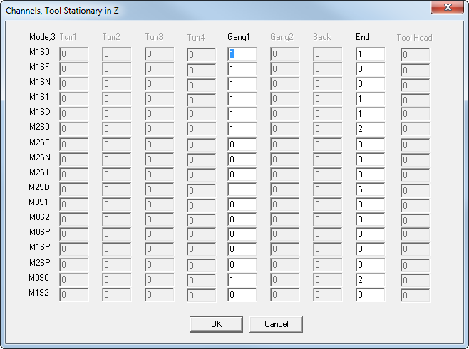

Channels, Tool Stationary in Z dialog
Note: This feature is not used in Basic Post Processors.
Use the Channels, Tool Stationary in Z dialog to enter specific channel numbers for available tool posts. The fields become available when the Tools Info dialog contains valid Tools Ranges values.
To display the dialog, select Settings > Channels, Tool Stationary in Z from the menu bar.
