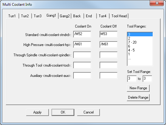

Multi Coolant Info dialog
Use this dialog to enter Tool Range specific coolant M codes for your chosen tool post.
Note: This feature is not used in Basic Post Processors.
To display the Multi Coolant Info dialog, select one of the options from the Settings > Multi Coolant Info submenu.
The fields become available when the Tools Info dialog contains valid Tool Ranges for your selected tool post.
New Range — Click to create a new range in the Tool Ranges list box.
Delete Range — Click to remove an existing range in the Tool Ranges list box.
Set Tool Range — These fields specify the start and end of the active tool range selected in the Tool Ranges list box
Coolant Codes — These fields contain the on and off coolant codes for specific coolant types. The entire code must be entered in these fields.
