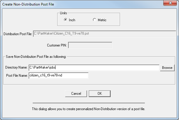

Create Non-Distribution Post File
ConfigPost displays the Create Non-Distribution Post File dialog when you click the Create Non-Distribution Post File button in the Open Distribution Post File dialog.
To create a Non-Distribution Post file:
  1. Select the Units that you want to use in the Post file.
  2. Check you have opened the correct Distribution Post file, by checking the following details:
    • Distribution Post File displays the directory and filename of the Distribution Post File you opened.
    • Customer PIN displays the Customer PIN you entered on the Open Distribution Post File dialog.
    If the details are incorrect, click Cancel to exit from the dialog. If the details are correct, continue to the next step.
  3. Check the Directory Name where PartMaker will save the Non-Distribution Post file and the Post File Name for the file are correct. You can enter a different directory and/or filename, if required.
  4. Click OK.
ConfigPost creates a new Non-Distribution Post (.pst) file (and .sub file, if required). It then opens the .pst file in ConfigPost.
