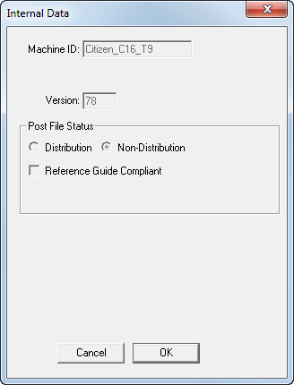

Internal Data dialog
The Internal Data dialog enables you to view the Post file specific information.
To display this dialog, select Settings > Internal Data from the menu bar. The fields in this dialog are always disabled.
  • Machine ID — Shows the internal name of the CNC Machine.
  • Version — Shows the internal version of the Post file.
Post File Status
  • Distribution — Shows that the Post file was distributed by Autodesk.
  • Non-Distribution — Shows that the Post file contains customer-specific information and cannot be redistributed.
  • Reference Guide Compliant — Shows that the content in the Reference Guide generated by the post processor matches the capabilities of the post processor and the machine.
Naming convention for Post files
When you create, modify, or save Post files in ConfigPost the character 'e' is appended after 'v' in the Post file name. For example, Citizen_M3_32-ve122.pst.
If the post is Reference Guide Compliant, the character ‘c’ is added after the version number of the post. For example, Citizen_M3_32-ve122c.pst.
