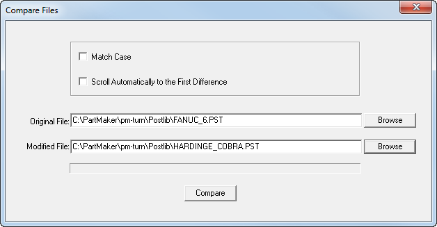

Compare Files dialog
Use the Compare Files dialog to compare two Post files.
To display this dialog, select Compare Files from the **** menu.
The following settings are available:
Match Case — Select this option to enable you to match case during file comparison.
Scroll Automatically to the First Difference — Select this option to enable the compare function to jump to the first found difference when the new format is displayed.
Original File — This field specifies the full path and the file name of the file that you are going to compare.
Modified File — This field specifies the full path and the file name of the file that you are going to compare.
Browse — Click to browse for the Post file you want to compare.
Compare — Performs the file comparison and displays the result in the Post File Differences dialog.
