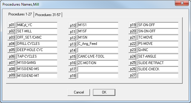

Procedure Names dialog - Mill
Use the Procedure Names,Mill dialog to name procedures for use in the Milling section of ConfigPost.
To display this dialog, select Settings > Procedure Names > Milling Procedures from the menu bar.

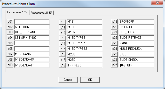

Procedure Names dialog - Turn
Use the Procedures Names,Turn dialog to name procedures for use in the PartMaker/Turn section of ConfigPost.
To display this dialog, select Settings > Procedure Names > Turning Procedures from the menu bar.

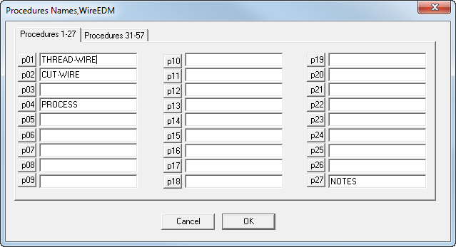

Procedure Names dialog - WireEDM
Use the Procedures Names,WireEDM dialog to name procedures for use in the EDM section of ConfigPost.
To display this dialog, select Settings > Procedure Names > EDM Procedures from the menu bar.
